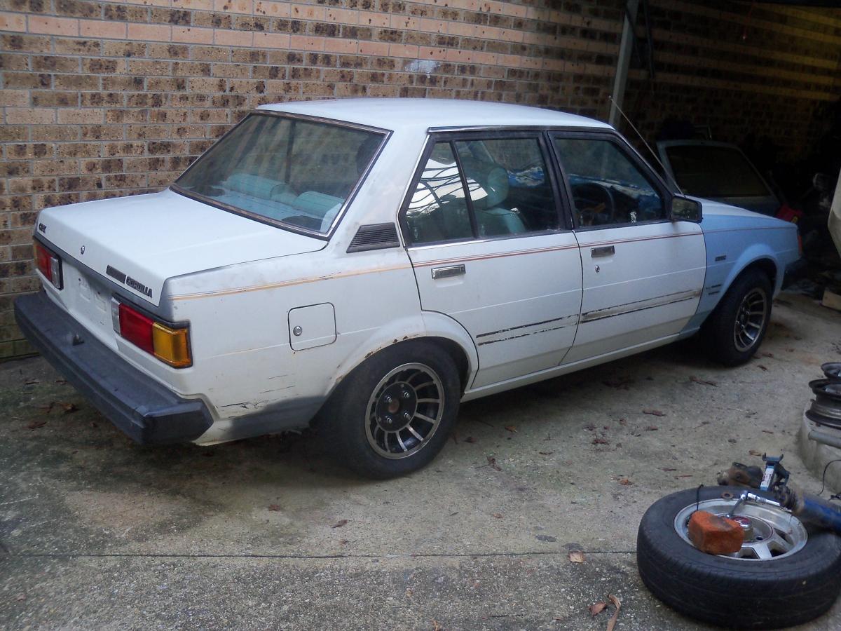

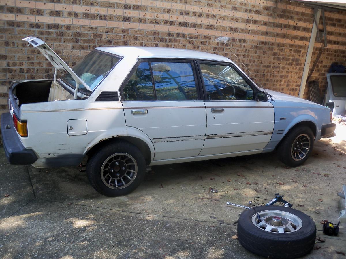

  3. Got motivated today and lowered the rear to match the front, used some shocks I had out of my wagon (which are shorter) to keep the springs captive cut about 1.5 coils out of the rear and 2 out of the front.I also changed my wiper arms as the old ones where rusty and bent.Also I managed to get another tyre on myself with a bit of difficulty and now it looks heaps better.Got some new points too but got the wrong ones got denso instead of bosch so have to take them back and exchange for the right ones. With the new rims before lowering the rear. Standard ae/ke sedan shocks (longer one), standard ae/ke wagon shocks. After lowering the rear.

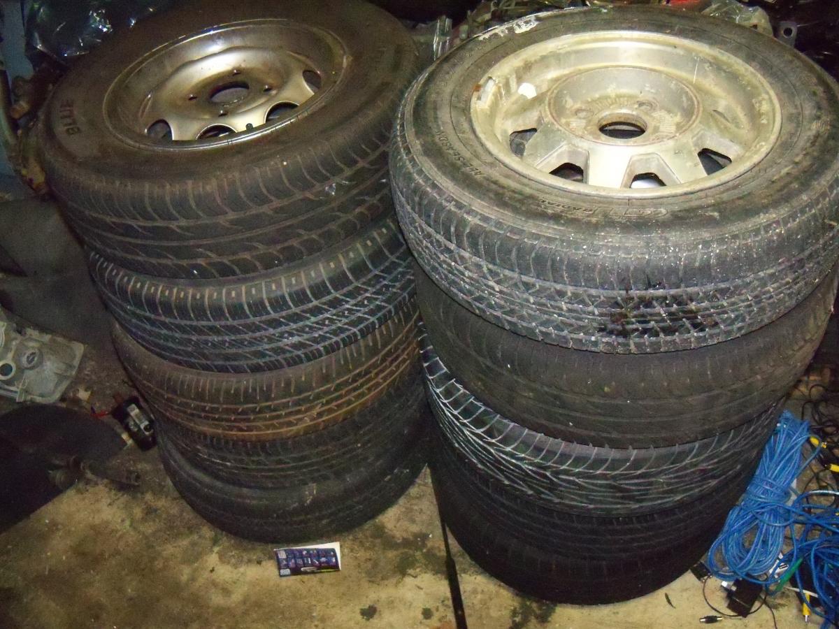

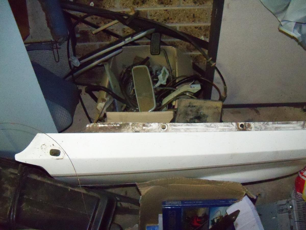

  10. Thought I whould post some pics of all the parts I've been hording, hahaha I think I may have a problem. The crazy part is that I sold about half the parts I use to have, now only my garage is full use to be the yard aswell.
