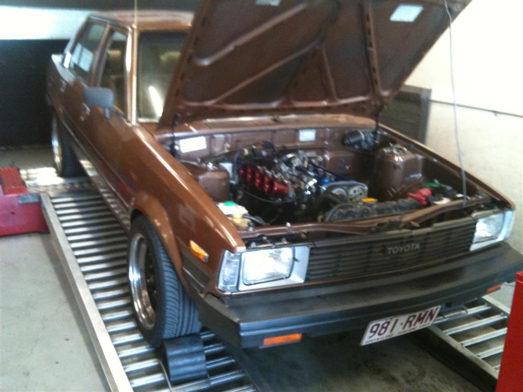

  9. well its finally tuned. Been having fun in this thing.
  10. Thanks for taking me for a drive out matt. Most fun ive had in the car thus far and was a great shake down for it. Car spent another 1/2 hour on the dyno this morning, pushing around 100hp up to 6k. Proper tune in the next week or so.

  14. Run in tune. 30 mins on the dyno. 4000rpm rev limit

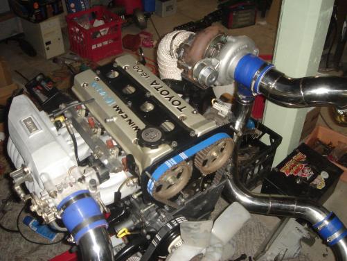

  16. I knew if I didn't paint the cam cover someone would recognize it :D oh if anyone wants the toda spec sheet for 264 toda cams ... Toda Australia did not give up the PDF file for them easily lol
  17. quick update so my thread doesnt dissapear into obscurity :P -adm ae86 shaft shortened 20mm new centre bearing, installed. -5'16 bundy tube fuel line installed with a z200 efi filter remote fitting near the fuel tank. walbro fuel pump. -all engine bay electics completed, alternator charging at 14.4 volts. -cooling system finished, with no leaks. I have my doubts with the current effectiveness of the system, may eventually get a custom pwr rad and alloy shroud setup. -and a huge milestone, the car now moves (drop it no less than 2 meters in my driveway, with a milk crate seat. :D) just a exhaust section to fab up, a drivers seat to go
  18. thanks for the positive comments guys I think I'm at the stage of this project car where ive got a stack of little things to do, that always seem to take up the most amount of time lol. specs at this stage. Blacktop full rebuild -new valve stem seals -toda in and ex cams 264deg 9mm retaining vvt -brand new toda valve springs. -trd .8mm headgasket -std bore acl race bearings full balance -oem pistons, conrods arp mains rod bolts and head studs -NPC button clutch and 4.9kg billet flywheel -T3 pulleys and velocity stacks Machine work done by chilton engineering, woolongabba and assembled by Elite racing developments in stapylton. water setup -rwd pump, thermostat bypass plugged with tig -blanking plate on the heater return -samq rear water bypass and yager top rad outlet. (thanks sam) suspension is bc coilovers front and rear st131 lcas and t3 steering knuckles to get running -install upgraded fuel lines -find a t50 reverse switch, as mines missing competely -obtain the required tailshaft setup for a 86 kouki diff -get an exhaust system -tune

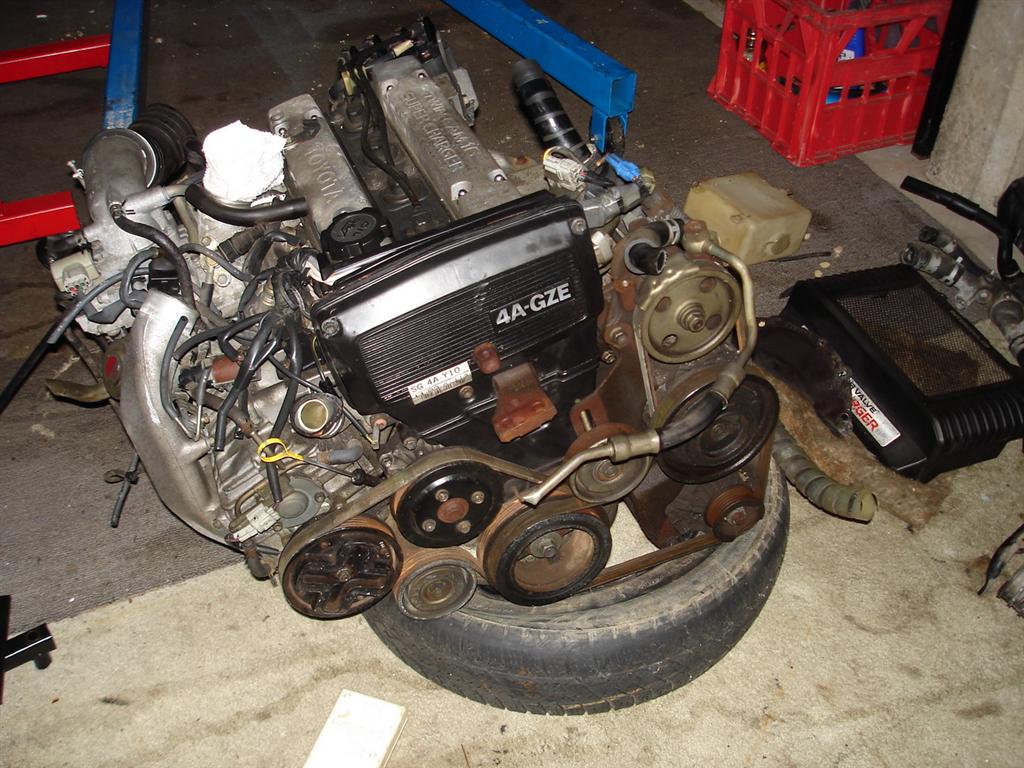

  22. I actually converted that engine. Bought it from an engine importer in sumner park. Converted it for use in a ae86. the sold it all in 2006 with a jdm box for 2600 on ebay, to a fella planning to put in a ford escort mk2. can't believe it hasnt been a runner yet lol.
