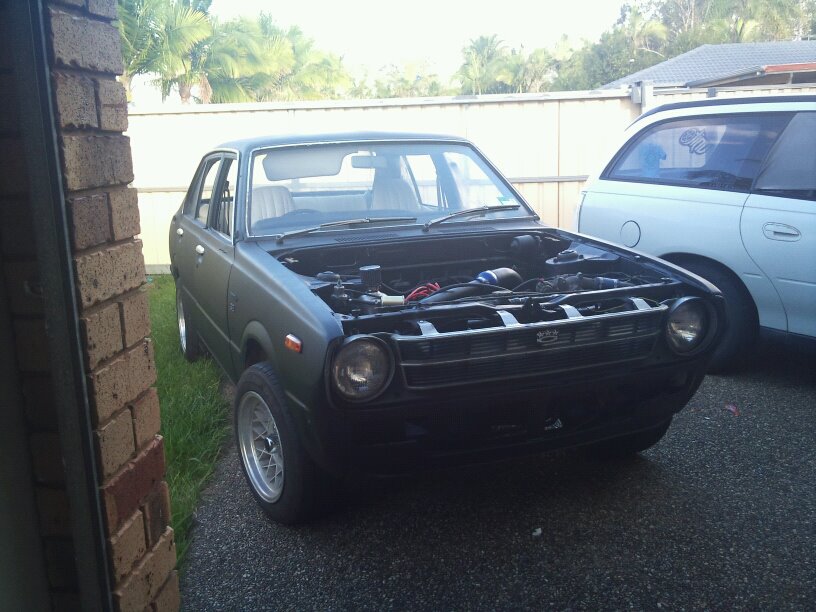

If you look at top pic you can see the intake pipe coming up from the front mount and onto the top of the carby..
I will upload a pic when i get home tonight, It was running fine at start of jan, and yeah standard carb and the intake pipe just screws on to the top of the carby, with a rubber seal. It has always worked fine. I Have already cleaned the carby and put a new kit through it.. When i leave the engine off and turn the throttle i can NOT see any jet of fuel squirting in.. So could it be acc pump?

another pic.. it is going in to be painted this weekend these pics are a few months old, getting painted white.
