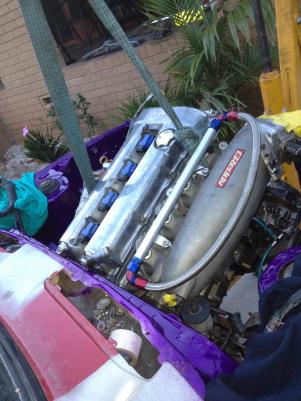

  4. finally brought myself to cut the gearbox tunnel out... now the motors all bolted up .... just need to get a new gearbox mount made up....

  8. motors in bolted to the crossmember ... had to release steering, crossmember and brake mc... all thats left to do is bolt the crossmember up to the chassis. will have to wait till tomorrow... gearbox is a reallllly tight fit ...and took all arvo to get it manoeuvred in... shifter hole will be moved and welded on the weekend

  13. How much clearance do you have around the box? I read you have a 25 box. They are big even comparing to a VLT box. theres plenty of clearance around the box ....and is defeinatly a lot bigger .its got a bigger tunnel been replaced before i got the car ....but its just getting it over the crossmember ...is being a bit annoying with one person doing it
  14. howd u get the old one out but not get the new one in old one came in the car but with this cut out of it .....if my theory dosent work tomorrow with the jack then i shall try cut a piece out of the motor

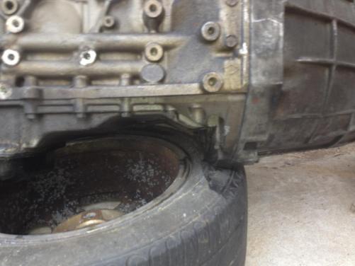

  15. and heres why it wouldn't fit
  16. and heres why it wouldn't fit
  17. no go today... can see what u mean about the circular lump :( the motor won't get over the steering rack / crossmember.... going to try get a bigger jack tomorrow and slowly roll the gearbox and motor back at the same time over it so it goes in straight..... or..... anyone else got a better idea?????????? don't really want to have to unbolt the whole front suspension / cross member and try slot the car onto the motor and gearbox.... ill have to grind a new hole for the shifter and weld up the old one aswell heres how it sits till tomorrow

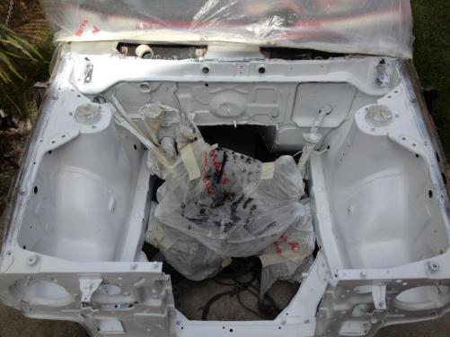

  21. bays all painted ... got my hubs brand new from toyota....
