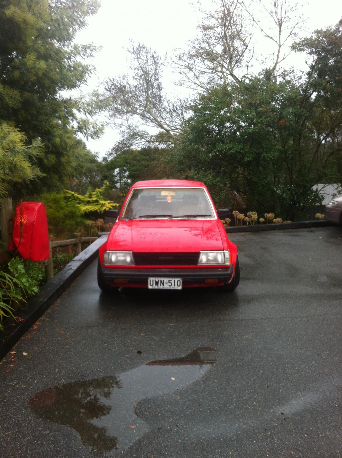

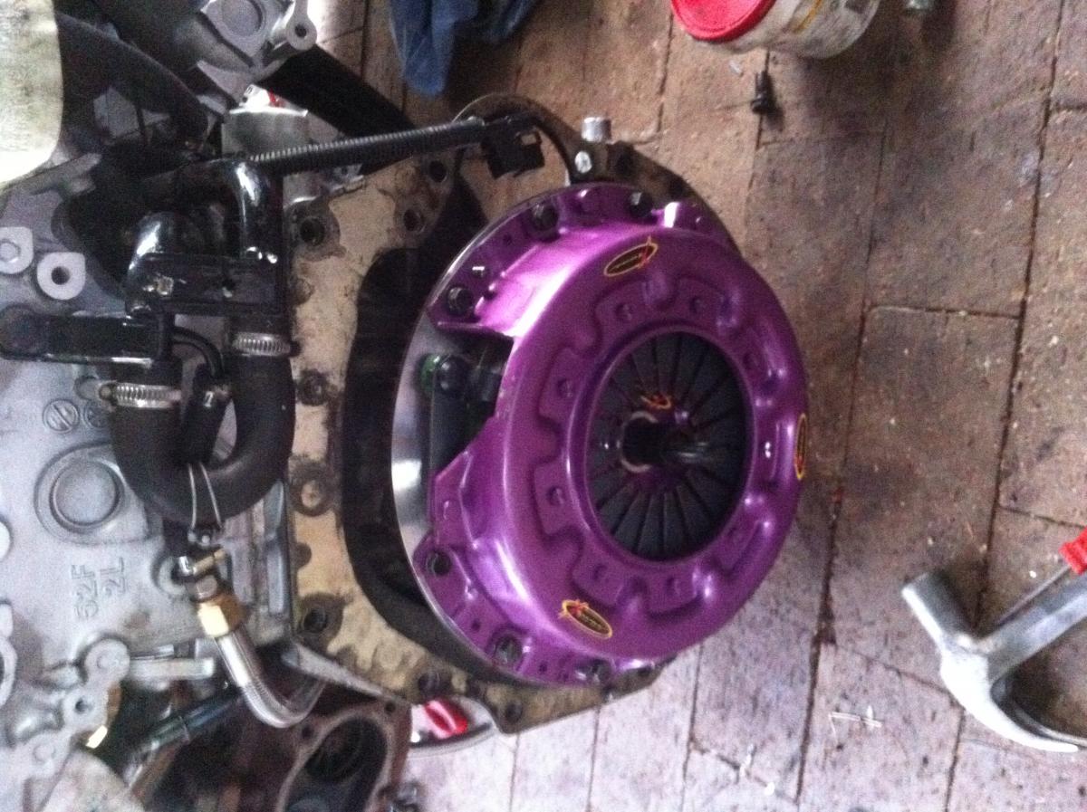

  5. i purchased a ke70 back in march 2011 and found out it blew the head. so i looked in the shed and had a sr20det siting in the corner so i decided to see if it would fit that were to project took off. so i fitted a forged sr20det in to a ke70 shell mods done to date ENGINE .cp pistons .eagle rods .cosworth head gasket .arp head studs .race bearings .top mount turbo manifold . garret 2871r .550cc injectors .z32 afm .bigger sump eBay copy .gktech roker stoppers DRIVE TRAIN MODS .extreme button clutch .sr20det 5 speed manual .moded ke70 tail shaft .r31 skyline diff .4.11 gears .mini spool BRAKES .stock fronts :S need upgrade asap .drum to disk rear vs commodore caliper .gu patrol master cylinder SUSPENSION .ae86 coil overs in front with 9kg springs .9kg rear lowerd springs .whightline sway bars front and rear .adjustable panhardbar .front+rear strut brace .front rcas .corona xt130 lca FUEL SYSTEM .60l fuel cell .2.5l surge tank .bosh 044 pump .charter lift pump .ally fuel hose . all speed flow fittings WHEELS performance challengers 16-10" with -27 offset
