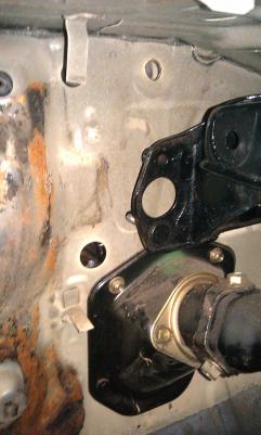

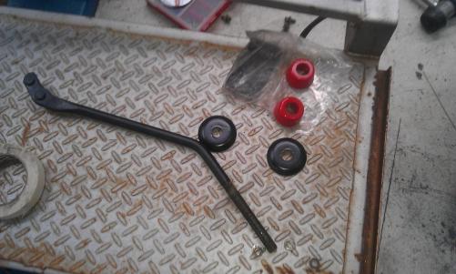

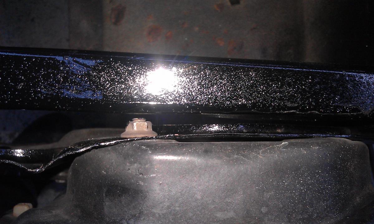

  6. FINALLY AN UPDATE! Sorry I haven't updated this in ages. I spent the following week finishing and perfecting my castor rod mounts. Went scavenging and found nuts, bolts and crush rod tubes to use. I adopted a mounting design used to mount tow bars to cars. It is to drill a hole at the bottom of the chassis the size of the bolt to be used, drill a hole on the top of the chassis as big as the crush rod tubes, then slide the crush rod tubes in the chassis and cut the down to a eight making them flush with the rail. pics of that I cut a plate of steel to use as sort of a giant washer connecting all three mounting points and spreading the load along the chassis Loosely bolted up the brackets to check everything worked. They're made of two sections of 5mm thick 75x75mm Angle Iron fliped then welded all along the join. The other side done Found some good Federal's for drifting. Cleaned up the rust on the tow hooks as I'm going to re-use them Added some extra bracing to the brackets and trimmed off the corners to make it look a little nicer. Painted the rails and brackets black Test fit the castor rods and they would have worked but I wanted to get the geometry perfect so I took them out and bent them again to get them exactly the way i wanted, I hope they're strong enough and won't straighten out. Guess we'll see. Happy with it I painted all the bits and put it together All done and gave it a quick alignment and it's running 6"18' castor a side. Reduces steering angle a bit due to the angle of the lower control arms but I'm fine with that. It does get an alarming amount of toe change during suspension travel due to the angle of the tie rods but one of the next things on the list is to move the rack forward and down to perfectly align with the lca pivot point height and steering arm pivot point. Filled the car with Nulon trans oil and ordered in 20 litres of Martini Racing Sint50 Engine oil, all $300 worth :o Loaded the car on the trailer on Saturday and headed home. When we got home the dolley wheel finally gave up and exploded with a massive bang which had the neighbours wondering what happened :P Finally back in it's home And my Fave pic so far, looks tough :D And that's it for now, I spend the next week organising stuff for my new job at my old job at Pancake parlour where I quit about a year and a half ago :P So now I have a job to continue funding this project :D but muuuch less time to work on it. Anyway I hope to start finishing it off now. Wiring won't happen till absolutely last now due to family reasons meaning my cousin can't help me out for a while but I'll get everything else done it the meantime. Hopefully not so long to another update then :)

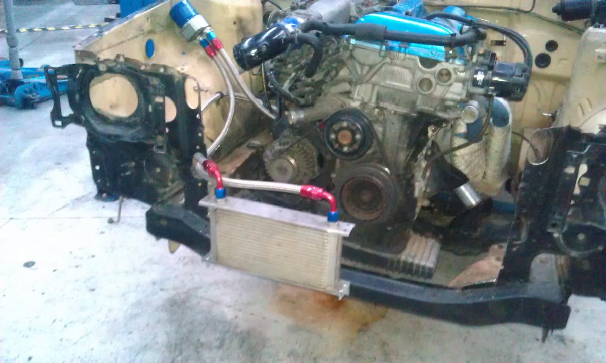

  8. Alright this update should have been up Monday night but I've been a bit busy. So a lot of little bits and pieces have been done Mounted my overflow tank I made up a mount for my oil filter Everything to do with radiator mounts is now done but incase I have to remove it again I haven't bolted it up properly I used the lathe to turned down the factory crush tubes to fit it the new ones for the castor rod You can see how it sits inside The next one was better as It was a press fit Machined up a bolt to use as the pin to connect my clutch master the the pedal so now all three pedals work :) I totally didn't pretend to be drifting in it :P My new bushes Cut off the nut for mounting the tow hook as my castor rod mounts will be sitting flush against this seam. And here is the beginnings of my castor rod mounts Was going to weld them to the chassis and so it would have been done now, but it wasn't going to be strong enough so am now going to be bolting right through the chassis using crush tubes so they will be beef as so now stuff needs to be bought and there's more to do so it'll be longer. I've been busy since Monday and will be busy until next Monday so there goes a whole week :( I hoped to have it home by the weekend So there you have it. It's getting really close :D

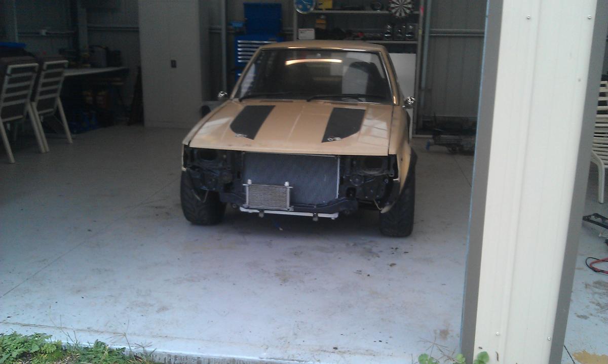

  10. Sorry for not updating Tuesday but it was the shittest day and basically nothing got done. Yesterday I just fell asleep before I could upload anything :P On Tuesday I put in my heater block off caps and then I spent hours testing sway bars we had upstairs then modifying my original only decide I'll just go without one for now and see how it goes. For drifting it should fine. I was doing this as I was going to try and encorperate the swaybar mount into the castor rod mount but with how the castor bars are modified I'm going to have to make a seperate mount. I then Swapped over to my Ke70 strut tops, I cleaned out the bearings and repacked them with grease, The bearings aren't flash but will do for a few months before I get camber tops. I fitted up the left hand side first but when I went to do the right hand side I discovered my shock had gone from a bit soft to completely f'd so I ended up ordering a pair of KYB Inserts. They were set to arrive tuesday at 2pm. Inserestingly The one that had leaked was a pedders insert and the other that was still good was the original toyota item; It was probably worth replacing both anyway to have an equally balanced front end. I checked my wheel bearings too and I think they've been replaced at some point judging by how great they are. So on to yesterday. I got to work around 1 as there wasn't much I could do except my shocks which would be there till later, as it turns out they arrived 10 mins before I got there so that was good timing. Now I have KYB's all round and the rears are only 2 motorkhana's old. In this pic stuts are back it and I'd cut off the tabs for the mudflaps on the body seam and painted the metal black. Then I got out the BFH and bashed the seam flush as I have cearance problems with it. Then I proceeded to check out how much lock I now have and am pretty imprest, It's more than I'll need and I have things hitting left right and centre :P The inner edge of the trailing wheel hits the arches so if I want any more lock I'd have to get longer lca's which I am getting as the next upgrade, I have now changed my mind again and decided to go with the battle version kit http://battleversion...lla-ae86-85-87/ From what I can find out they're great other than not having enough castor adjustment but as I'll have to make new mounts again this isn't an issue, anybody have any input on my choice or other ideas? The leading wheel hit the back of the arch but that's just because I have no castor rod mounts so it pulls back as I turn, I have just about a mm clearance with the tierod to lca as the inner tyre hits first but there's still more rack travel left, I'll have to check everything when I mount my castor rods. I might for now until my new lca's put in lock stops to stop the tyres rubbing on the inner guard. Today not much will get done as grants not in to help with the castor rod mounts and I'm working the rest of the week so looks like it'll be Monday before another major update but if I get anything done today I'll post it up.

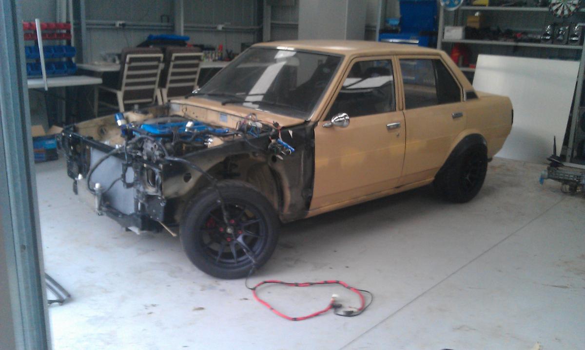

  12. Time for an update, sorry it's been a while I've been lazy with the updating. So on thursday I came into work. This is how far trent got mounting the radiator. Tack welded to frame. Needed a bit of work. I cut the protruding oil cooler mount bolts as they were to close to the front of the radiator, grinded the welds on the lower support as it fouled on the bottom of the radiator and as he'd only used the bottom factory bushings and had it metal to metal fixed at the top I went rumaging upstairs to find something suitable and ended up using link pin bushes that I then sanded down on the belt sander. Cut the front down to the height of the support and sprayed it black just to stop it rusting Then Re-installed my headlight brackets, cutting the top bolt down so it fit. Put my castor rods in to see how the cleared everything, and had a talk to grant about mounting ideas. Drilled and bolted the crossmember to body, so if I have to remove it All I have to do it grind off tacks and unbolt it. I worked the first half of friday, But my adjustable 4-link and panhard rod arrived! Yay I installed the panhard rod then rolled the car outside. Trent had bought an r33 gts-t the night before and it needed a clutch, so it went on the hoist I was using. If anyone else has done this you'll know it has got to be one of the hardest F#%@!$ING clutch swaps do in a car, There is no clearance anywhere, but we worked after hours and got it done. I'll post a pick of his car on Monday if I remember. Anyway, as usual Saturday is just work, So you'll have to wait till Monday to get the next update which should be my castor rod brackets which will be the last thing to do in the workshop the back home it is to finish it :) I also have to strengthen the lower radiator mounts and then I'll bolt that in. My sister got a new car aswell and today we put some rims on it EDIT: I realised you can see the R33 behind My sister's Colt. Just.....
  13. Sorry I didn't update yesterday, I was tired and didn't get much done anyway. The transmission crossmember was finished and painted. I have to thank Trent who works at Traction for doing the welds. Although I can weld I don't trust myself yet with structural pieces. All bolted up. My speedo drive was leaking and it was the gear not the seal so seeing as I'm not running a speedo I cut a plate and sealed it up. That was all I took pics of but I cut off the seam that mounted the front of the castor rod brackets, had trent weld the seam back together but it was a hard metal to weld as it's so thin and works welded isn't very good, especially with thin metals so he repeatedly spot welded which ment an age for me with the grinder and I cut the radiator support panel at both ends in such a way to bring it forward It'll need welding to finish it. Today I didn't go in as I was ment to be installing a sub and amp in a mates car but there were delays and problems so it never eventuated which seems a bit of a waste but I heard we were quiet today so trent actually finished off mounting the radiator for me which is great. I should be going in to work tomorrow so hopefully another update tomorrow night :)

  17. Thanks for the great ideas I didn't think of using those, I have a wrecked camry in the backyard that i'm pretty sure has pinch weld around the doors so i'll steal that ;) Didn't get anything done today as work was flat out, but had enough time to find a problem with mounting the radiator. ITS TOO BIG! :P Haha. It's too tall to stand up because it will foul on the bonnet big time and if i lean it back I can't run the hoses, even custom ones wouldn't work, so what i'm doing is removing the factory caster rod and sway bar brackets so i can drop the radiator through and mount it upright then I'm going to fabricate new brackets. My mate Grant has done engineering so he's going to help decide exactly where to mount it for the best handling. The major factor here is bump steer. While it's seems a lot of work to mount radiator it isn't really as because when i go to an all rose jointed front end I have to re-enforce the brackets anyway and also I'm designing it so when I 'slam the bitch on the ground' It won't take much modification to run perfect geometry again. In doing this too i'm going to find a shorter swaybar, so I have more clearance for lock and I can mount it now to clear the sump and everything else :) I've also been thinking; I had desided to go with the xtr competition lock kit which included lca's, steering arms and castor rods. but I've decided when I get some money a little while down the track I'm going to make my own. I'm also going to mini tub the front gaurds while it's at work and look into moving the steering rack forward. So as you can see the original concept of just getting it to run atm has become quite involved to say the leased! Another thing I'll say as well is that I'm going to set the best possible rear geometry with the adjustable four link and when she is slammed, to match the front I'm going to raise the rear floorpan, mini-tub the guards and fabricate box sections for equal length arms. Another update Monday when hopefully the radiator and transmission is mounted ;) I will also swap in ke70 strut top to increase caster. EDIT: Can someone tell me, do I need to run a front bar for drifting? or is just the front beaver panel ok? If not will some circular tubing bent up behind the panel do? what about a rear bar? Cheers

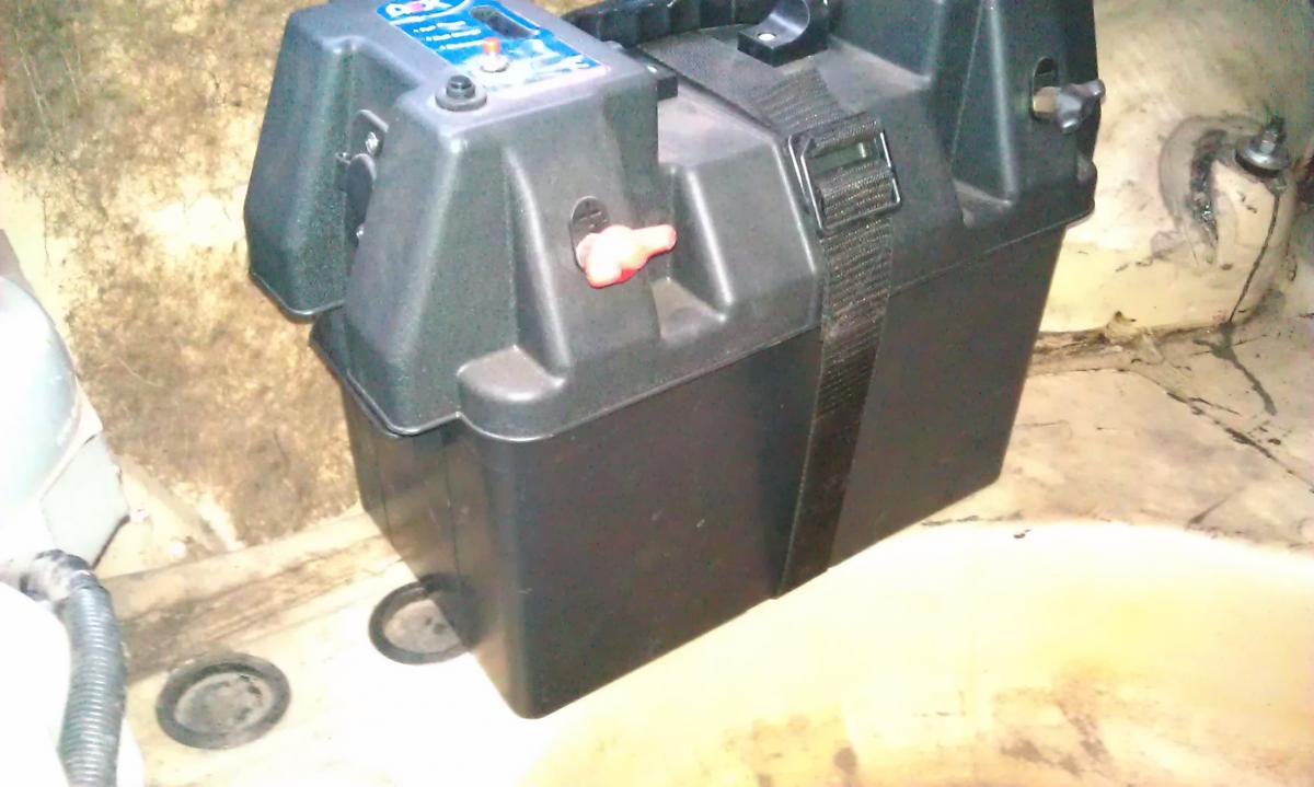

  21. Alright, I finally feel like this thing is coming together! So having my hands looking like I went 3 rounds with a brick wall is worth it :D First up today I finished up mounting the battery box. I used 4mm thick steel to make washers so the pressure is spread out more making it very strongly mounted. I had to move one mount; I explain why in last post. There is half a mm clearance with the boot hinge when it closes :P My shiny pedal box Unfortunately the box was very slightly twisted, only by about 2mm but enough for the bolts not to line up with the top ones. So I clamped it in a vice and twisted it back with a pry bar. Then lined it up on the inside, marked the bottom bolt hole for the clutch master and the preceded to drill t the holes for it........................................................................ However I forgot to bend the brake like before I drilled and it went through the side of it :bash: Anyway, it's not a big deal I'll get one from a wrecker. Finished of the holes and mounted it and the clutch master cylinder. I then set about today's main task of filing the mounts to get the engine to sit correctly and have the mounting surfaces perfectly flat as any uneven mating wil destroy something as i'm solid mounting everything. I ended up putting a large suspension washer at the bottom of the mount as the crossmember mount on the drivers side was slightly collapsed and the other wasn't perfectly flat. It took quite a while but I got them so perfectly flat even I was surprised, and thrilled!!!! :dance: I swapped the flexible fuel return line at the tank with almost new line and my fuel line to use for the breather arrived but i'll do that tomorrow morning. And a random pic of me working out how I'm going to mount the radiator and oil cooler That's it for today. Tomorrow's goals are -source and fit a new brake line to replace the one I broke -run breather line -finish transmission mount -Work out a clutch line -Trim up the hella mad drift pipes :rocknroll: I don't mind the look but it's not really my style :yes: Could someone please tell me if I get an ae71 clutch line if it'll work? Cheers :)
