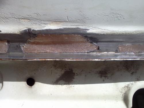

    Adelaide

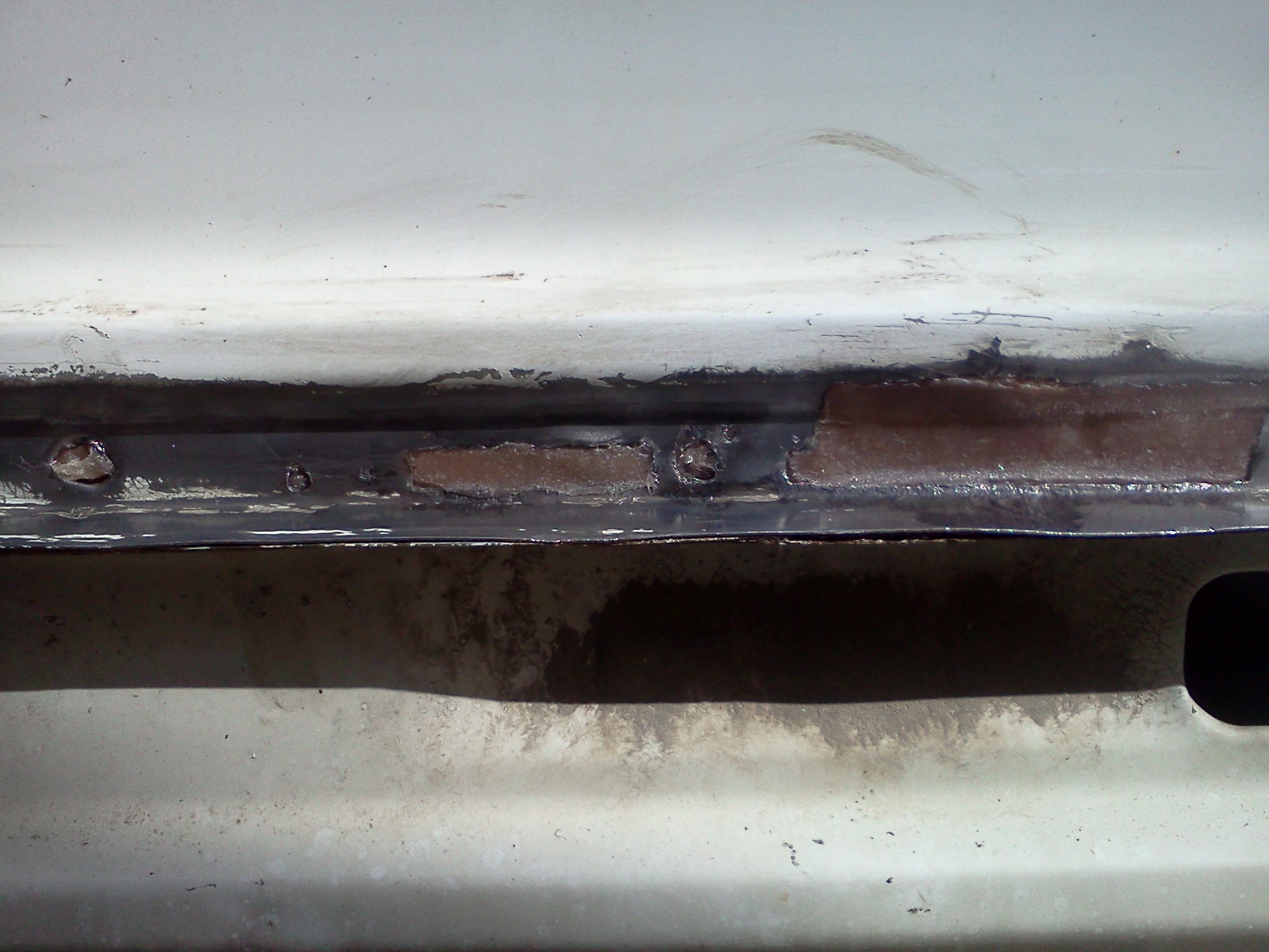

  3. ok so i decided to start on the smaller holes, for this i decided to use ReoFill (Fibreglass Reinforced body filler). i started of by using acetone to clean around the areas that i had cleaned with a file/sand paper and a wire brush. Once clean i covered the holes with masking tape on the outside(have photos if need be). once the tape was in place, i mixed the filler and applied it from inside the boot. this created a wall so that way when i want to fix up the outside so it looks nice, i can do so by having a supported structure across the back. i have uploaded some photos of how it looks from the outside after i pulled the tape of (this was about 2 hours later).

  6. as you can see by one of the pics i have started to get it back to bare metal,i just wanted to get some ideas before i progressed to much more.
