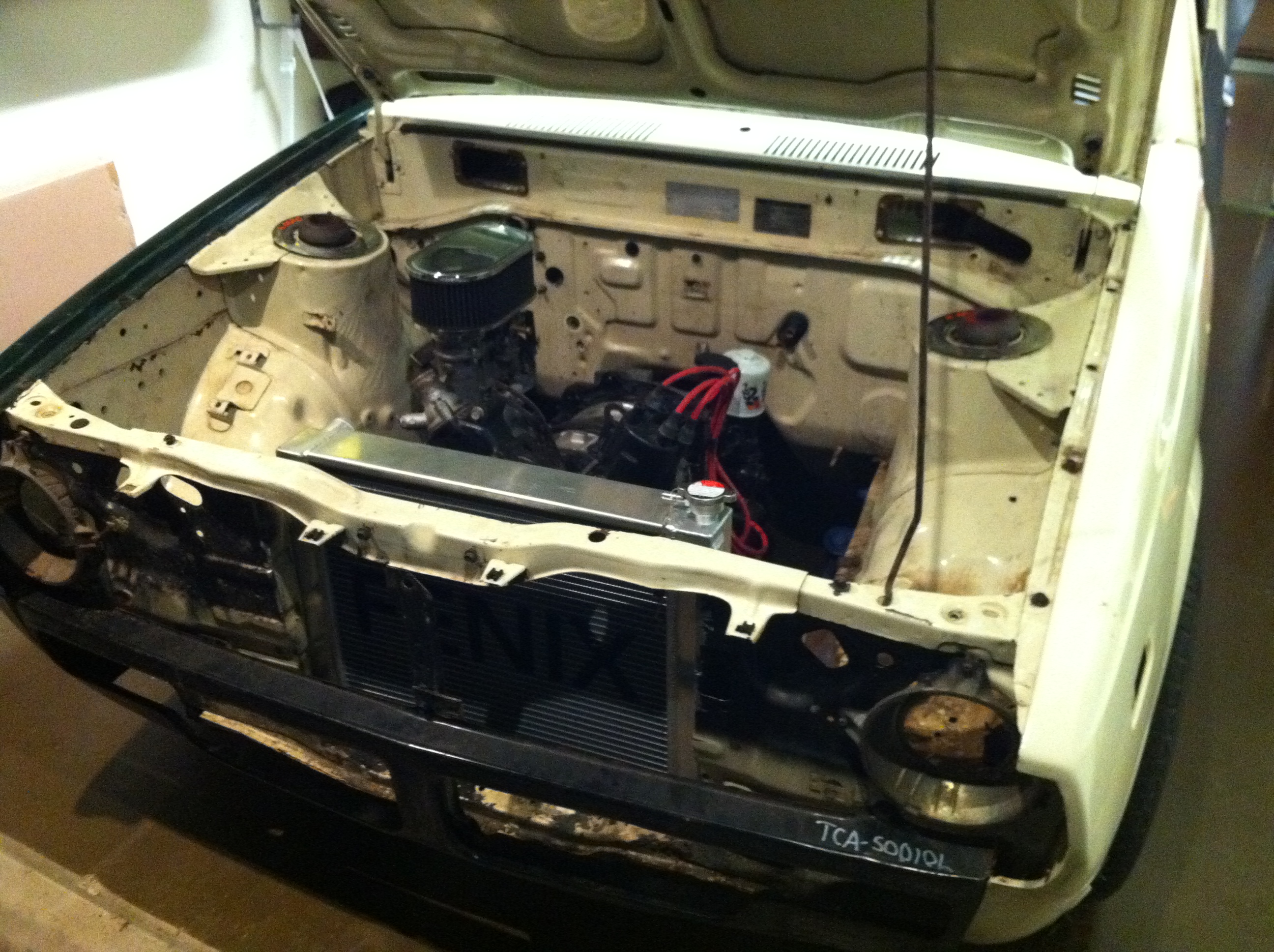

  22. been a bit slack but starting to get back into it again here are some pics of engine in the 4 dr
