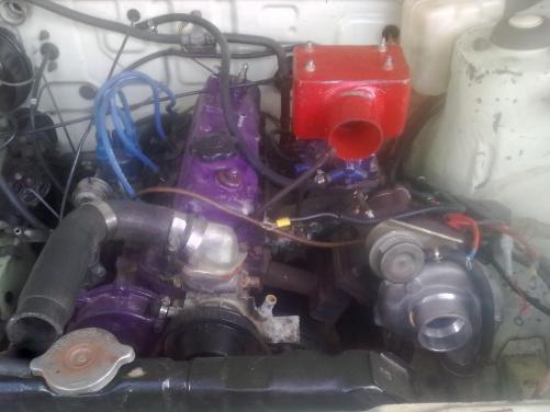

    yeah it was 4 spd but now its 5spd :) getting a respray in the next few months too. now for an update... took the head into the engine works place and got it cleaned up, valves reseated, all the seals done (used the original head because i knew it wasnt cracked or anything rather than wasting time on the shit looking purple one lol) i noticed the two heads were different which u will see in the pics that there is a shoulder around the valves on and the old one is flush the engine guy said it looked like a 3k head so let me know what u think ;) over all I'm pretty happy with the way it looks just need a new set of head bolts and ill put it back together and turn the key and hope for the best anyway here are the pics

    Hey guys, Just a few things about it... its done 206000k's, still got the 4K in it but its turbo :) converted to 5spd with short shifter, lowered on 13 inch splats but i have new wheels for it (still have the others but wanted a change for a while) 2 inch exhaust. not yet tuned with the turbo on it but looking good so far. it runs and drives but doesnt like boost atm coz it doesnt get enough fuel when it does so. will be tuned next thursday tho :) interior: stock but very good condition Exterior: lowered on 15ns have other wheels which u will see Engine: stock 4K T25/28 turbo (no J pipe) 2 inch exhaust, xr6 turbs front mount Fuel system: Carter 18psi in line fuel pump, malpassi rising rate pressure reg. will update when its tuned, going to run 12psi through it too
