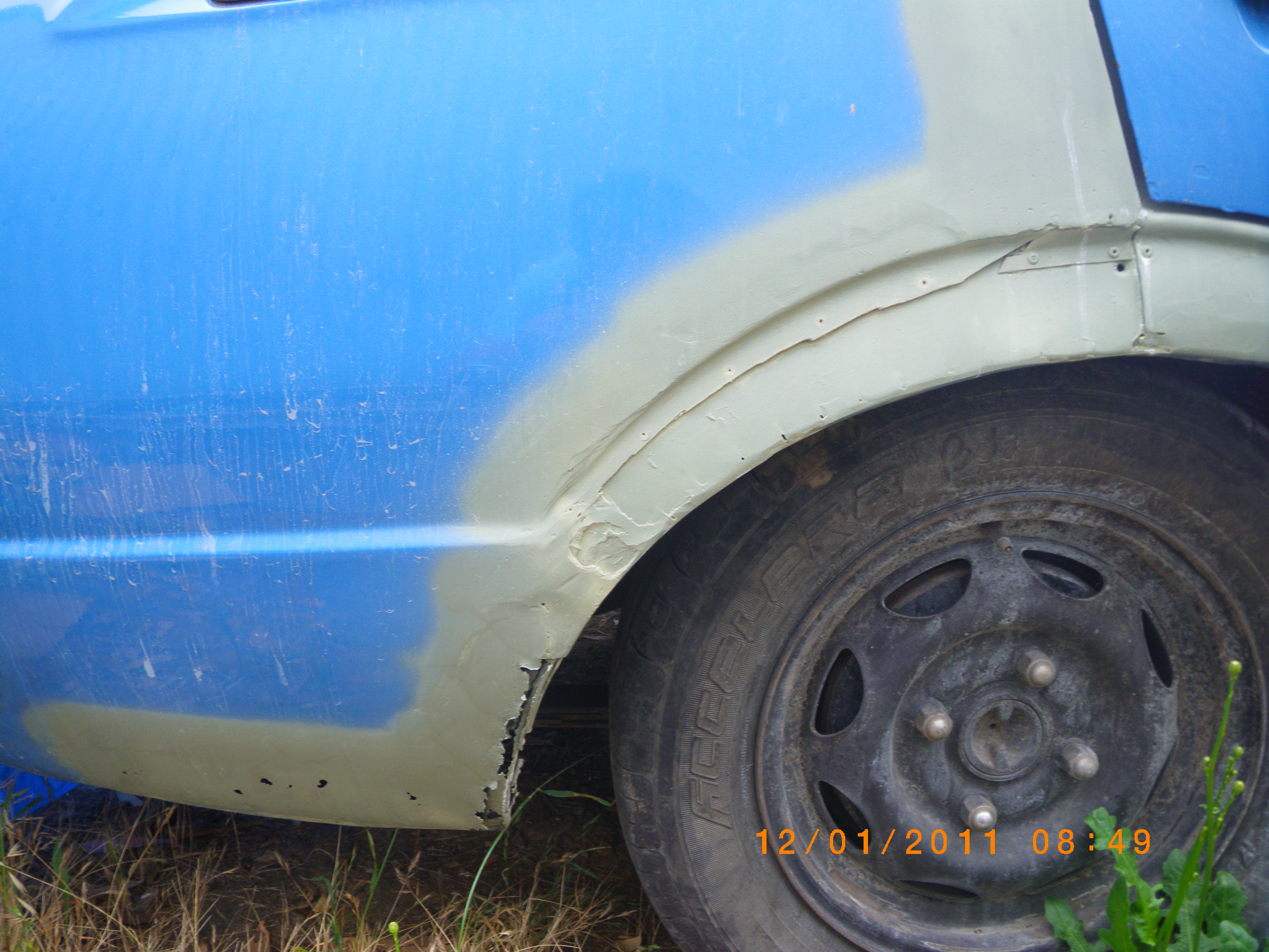

Contact Methods

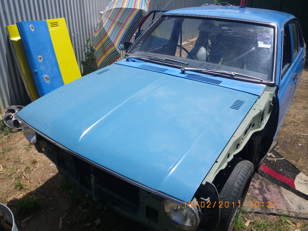

Reputation

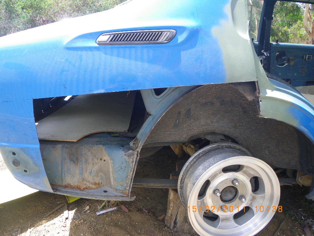

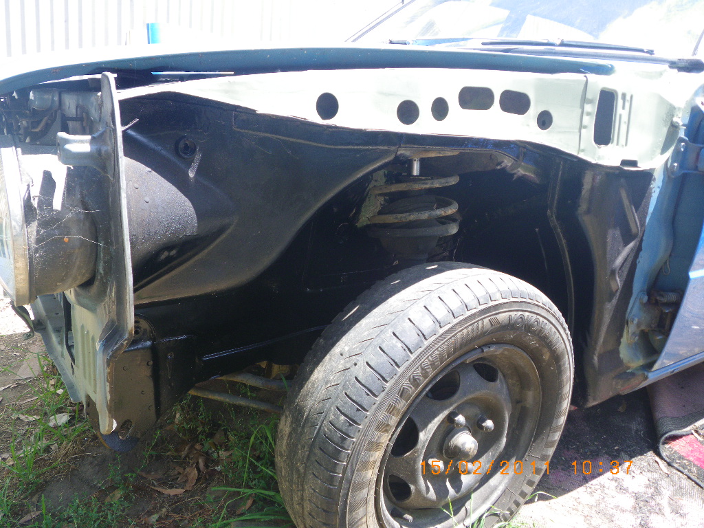

  1. Bit of an update: -Pulled the fron end appart -rebuilt struts with low king springs -painted all components -replaced all bushes with nolathane gear -mounted whiteline front sway bar Finally convinced the rents to buy a welder :) and have tacked up the panel sut out of the rear right mud guard. Still a long way to go b ut making progress will post pics soon

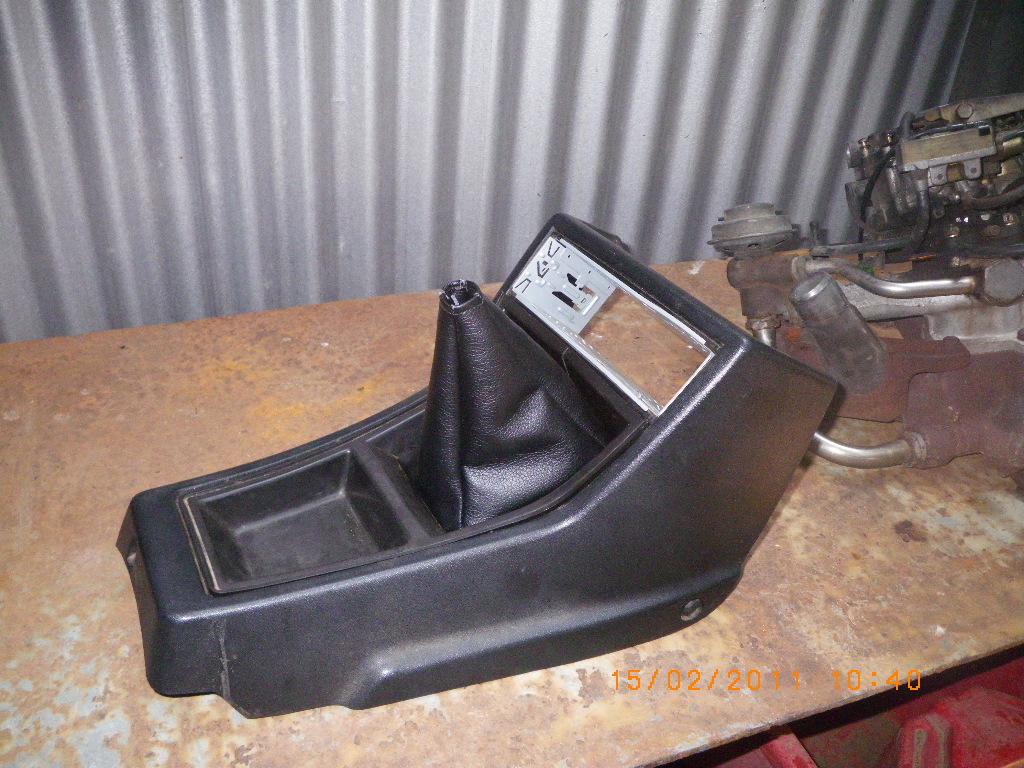

  4. Bit of an update, still haven't got a welder do do the rear quarters so ive moved onto the interior, replaced all of the foam arround the air vents as the old ones were perrished. Made one good console out of two. jumped on the sewing machine as well and made up a new gear stick booty thing. ps has anyone reconditioned a stearing box before?

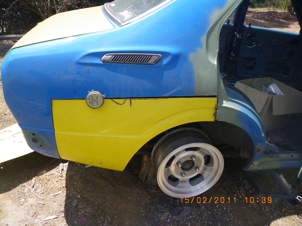

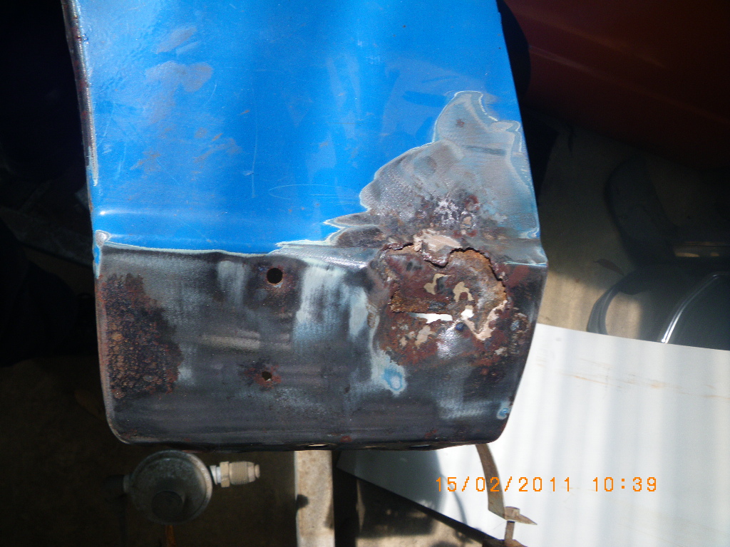

  6. Bought some rear quarter cuts to repiar the rust arround the wheel arches. The rust had gone through both layers of metal so had to chop out a bit. took a whole day of stuffing around but managed to trim up the new panel to fit, ready to weld in.

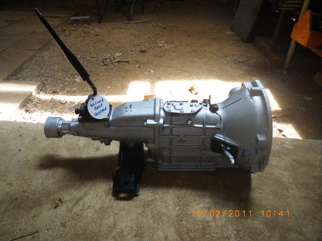

  10. Picked up a k-50 gearbox the other day to drop in, will put a new clutch in while I'm at it

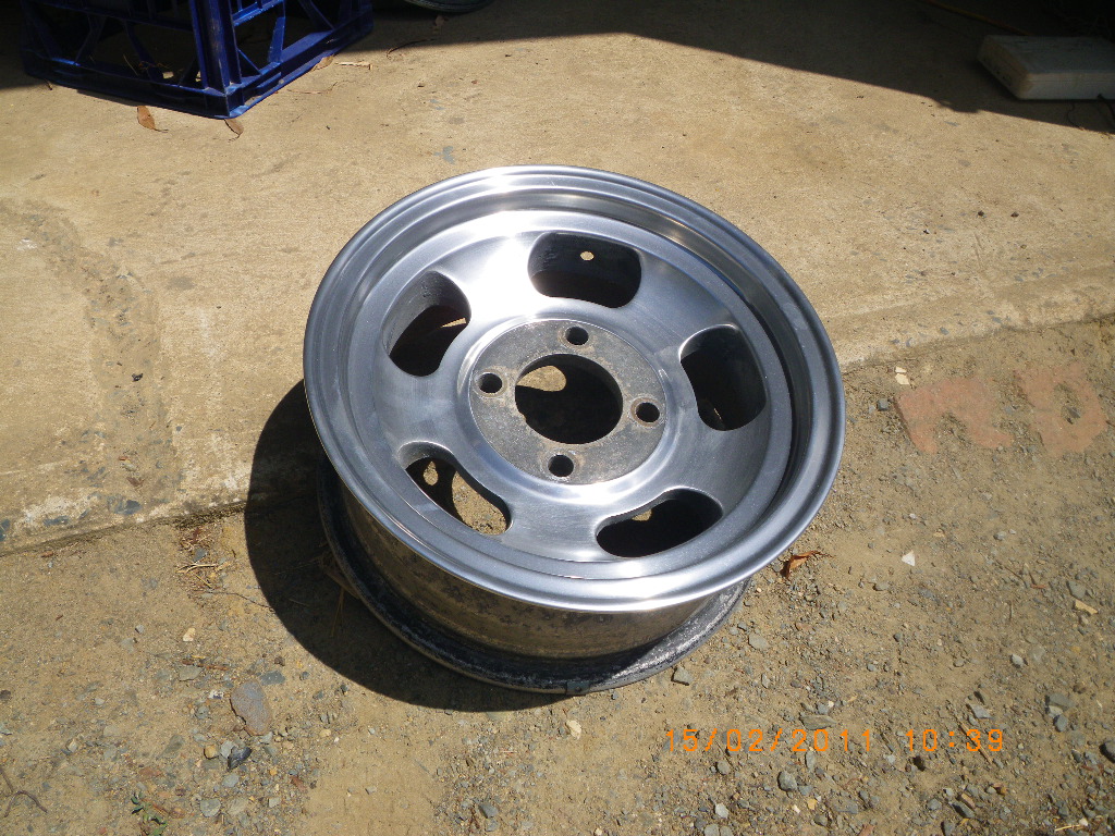

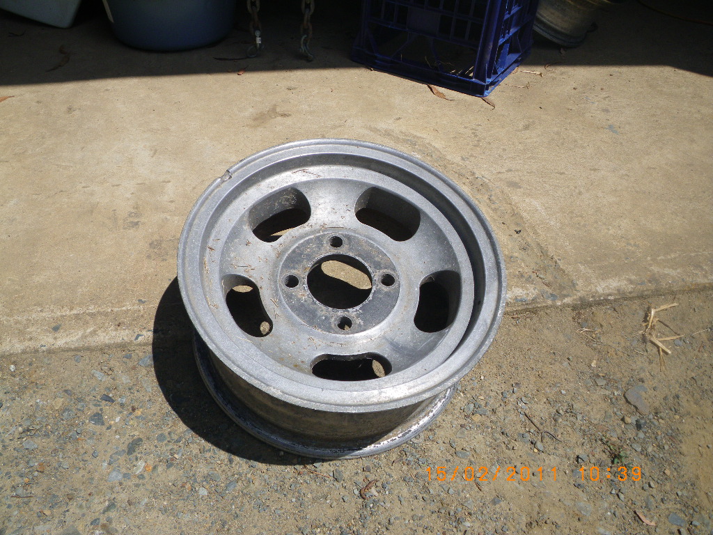

  11. Jacked up the back of the car, bolted the rim on and ran a file around the edge to get rid of the gutter rash, then used 80 then 240 grit emery cloth. Finished them with 600, 1000 grit wet and dry and then some heavy duty cutting compound and a felt pad.
  12. Picked up a set of 13" jellybeans for $50 should shine up ok.

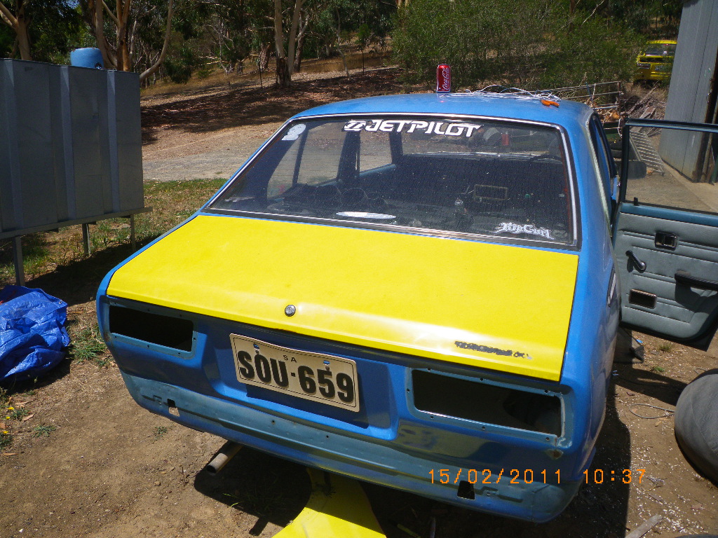

  14. Will look into rust repair panels both guards are similar Cleaned out about 10kg of dirt hiding under the front guards and repainted the mudguards with a bitumus waterproof paint. Bought a old wreck which has been really handy for heaps of bits, grabbed the boot lid, bumpers and heaps of interior stuff. Picked up a Ke30 bonnet, doesn't quite sit flush so will have to adjust the hinges or just shim it. need to source a KE30 bonnet latch as the hook fowls on the bonnet loop.

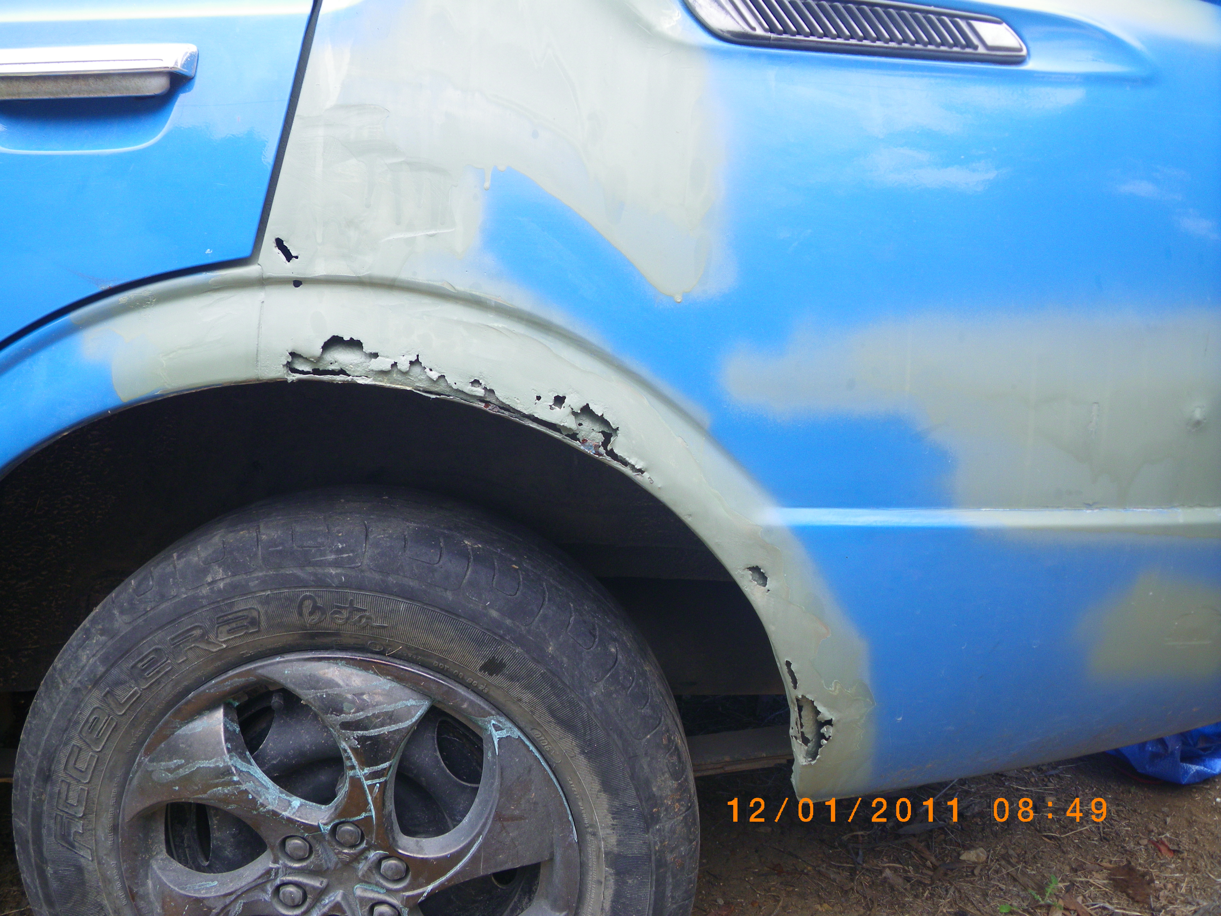

  15. Just atarted with a sanding wheel on the angle grinder and the few rust spots were a little more extensive that i thought uncovered a dodgy job benieth a lot of bog
