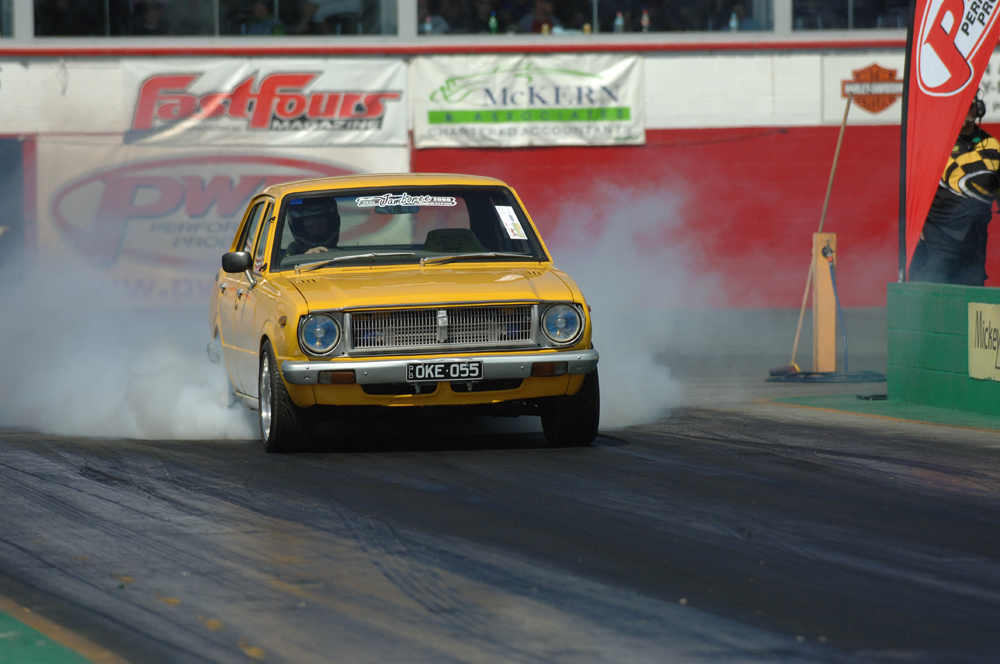

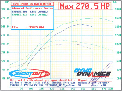

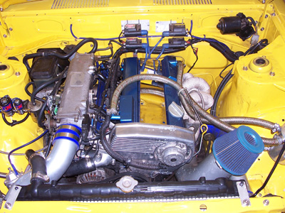

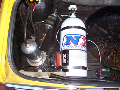

OKE055 Posted September 9, 2006 Report Posted September 9, 2006 (edited) 1978 Toyota Corolla KE55 Owner: Shane Hill Toowoomba QLD Engine: S13 CA18DET Engine Improvements: Block crack-tested, bored 30thou, modified oil galleries, Arp block stud kit, modified standard rods, Arp rod bolts, Cp forged Pistons, Cp rings, Ported head, oversized valves, Arp head stud kit, CA16 inlet camshaft, Tomei adjustable cam pulley, Gates timing belt, Garrett GT2876R, JR 4in pod filter, xspeed stainless steel exhaust manifold, 3in dump, 3in hi flow catalytic converter, straight-through muffler, 450x300x75 hybrid intercooler, RB20 throttle body, custom intercooler pipes, HKS super sequential blow off valve, Microtech Ltx8, 3bar map sensor, GReddy Profec B electronic boost controller, individual bosch coils, Bosch 044 fuel pump, surge tank, Pieberg lift pump, 13b 550cc injectors, oil catch can, oil cooler, relocated oil filter, ARE 28mm upgraded radiator, twin Davies Craig thermofans, heat wrapping, Nx Nitrous System. Performance: 270.5HP @ wheels no nitrous 12.857 @ 118mph 2.235 60ft old street tyres Driveline: S13 CA 5speed, 3200lb 5puck brass button clutch, custom one-piece tailshaft, shortened R31differential, custom axles, 4.11:1 LSD diff centre Brakes and Suspension: RDA slotted rotors, EBC green stuff brake pads, RA60 disc and calipers (front), RA60 Celica struts (front), R31 Skyline disc and calipers (rear), Ke55 wagon leaf spring with extra leaf and reset, slapper bars Wheels and Tyres: Front †Zepter 16 x 7 rims, 205/45 Falken Azenis RT215 tyres; rear- Zepter 16 x 8 rims, 215/45 Falken Azenis RT215 tyres Interior: Velo race seats, harnesses, new carpet, velour retrimmed door card, roof, rear seat, vinyl retrimmed dash, wheel well and parcel tray, Microtech digital dash, Battery isolator, autometer gauges boost, oil press and air fuel ratio, momo shift knob and boot, isotta steering wheel, isotta shift indicator, Vdo 200km digital speedometer Edited May 7, 2011 by OKE055 Quote

OKE055 Posted September 9, 2006 Author Report Posted September 9, 2006 (edited) I am going to be racing at Jamboree this year am having the car tuned on the 18th of september with the nitrous and playing with the cam timing to get some more power and am hoping to better my 1/4 mile time considerably. Hope to see a few of you guys there Sorry i haven't kept you guys updated i haven't been online for a while Edited September 9, 2006 by OKE055 Quote

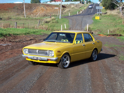

OKE055 Posted September 9, 2006 Author Report Posted September 9, 2006 (edited) 11/78 front converted to round lights i think it has ke30 grille and i know it has ke30 bumpers didn't like the rubber ends on the ones i had Edited September 9, 2006 by OKE055 Quote

Rolla__Boy Posted September 9, 2006 Report Posted September 9, 2006 It's a KE55 grill, and a KE55 bonnet. And it's a damn nice car Quote
ca18rolla Posted September 10, 2006 Report Posted September 10, 2006 (edited) Sweet to see its still around mate. Good curve on that dyno sheet makes power nice and early! We are runing almost the exact motor combo mate same pistons and everything only I m running the GT2876R. How you go for traction and axle tramp??? Hoping to make jamboree as well! Ha we both running thae ke55 bonnet and grill too lol!!! Edited September 10, 2006 by ca18rolla Quote
