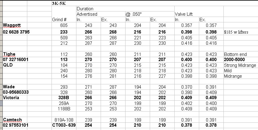

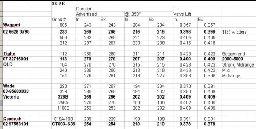

altezzaclub Posted November 2, 2009 Report Posted November 2, 2009 (edited) I'm assembling the stuff I need to fit twin inch & 1/4 SUs, 4-2-1 extractors and a cam to the KE70. Seeing its road use only (maybe the odd gymkhana..) I'm happy with 1" & 1/4 carbs, and also we live at 2500ft at Orange. For those of you who can't appreciate the difference a couple of thousand feet makes, the KE runs fine with the ignition settings we have at home, but pinks as soon as we go down to Sydney. With cams that means lift is important over overlap. To successfully rally at Jo'burg (6000ft up) and Cape Town (sea level) means a change of cam and carbs each time. Jo'burg also doesn't offer the same high-octane fuel that Cape Town does. I'll get the followers re-surfaced, but don't intend to lift the head so stock compression and valve springs. I've sorted a list of cams from the net, bolded the most likely ones for what I need, and was wondering if you had any comments about which company had good or bad work, or cheap or expensive. I can start with Tighe, having sent them 3 emails over as many weeks asking them to suggest a cam, and received no replies! Some companies will not survive the digital age! Edited November 2, 2009 by altezzaclub Quote

altezzaclub Posted November 2, 2009 Author Report Posted November 2, 2009 KE55 I'm happy to do that, I'll dredge up cam grinds from these through to road-race like you fitted. However, it seems like Crow don't cut K cams any more, its all twin-cam stuff on here- http://www.crowcams.com.au/search.aspx The comments on where a cam really works and if it needed new valve springs/compression will help if people want to use it as a reference. Thanks Felix, as you can see my Tighe option was a 113, but from your post its probably a bit hot for what I'm doing. Currently I'm planning the Waggott 233, as although it has similar durations it opens really quickly, as you can see from the 50thou readings. Cheers Quote

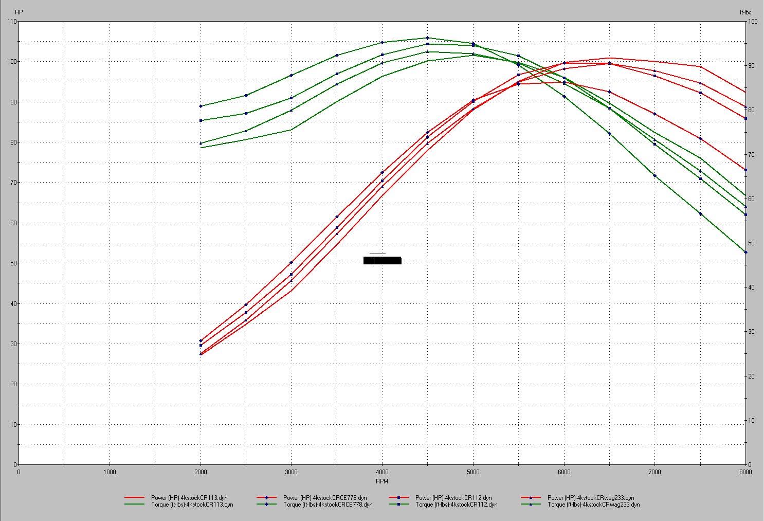

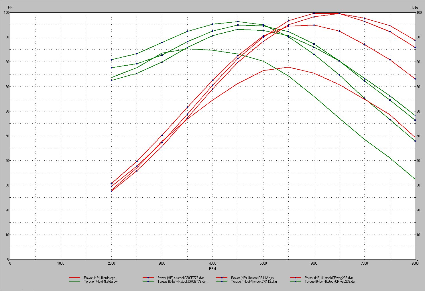

Felix Posted November 2, 2009 Report Posted November 2, 2009 No worries. Thought you might be interested in a few screen grabs I just made from Dyno2000. Please note, take 10-15% from the HP numbers for more believable real world results, the software is used more for comparative rather than outright numbers. The motor is a 4k modelled with 9.0:1 cr, stock sized small ports, and small tube extractors with mufflers (stock 4k has stock manifolds and mufflers), airflow is as for a downdraft weber (except stock 4k) as it is fiddly modelling SU's. Took out the 113 and threw in a stock 4k for comparison. Quote

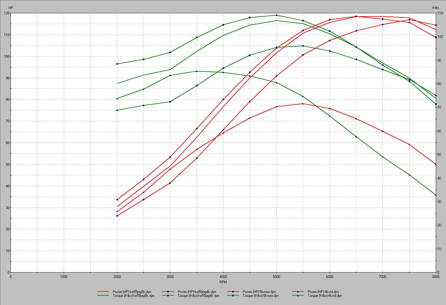

KE55PIG Posted November 2, 2009 Report Posted November 2, 2009 (edited) can u do 2 plz one a 4k with extracctors with my cam twin 3k carbs 32ml inlet ports. 10.5.1 (going in by christmas) 5k 32 ml ports eg bp twin carbs and my cam with extractors 10.5.1 (Hopefully march) 4-1 extractors u can play a bit with lil higer compression if ud like that would be good cheers Edited November 2, 2009 by KE55PIG Quote
Felix Posted November 2, 2009 Report Posted November 2, 2009 (edited) altezzaclub the Camshaft Engineering cam was in a 5k bottom end I bought. It was actually a hydraulic grind but seemed to run fine with solids. Anyway that is besides the point you could get any decent cam grinder to grind to whatever specs you wanted in a solid grind. And yes I ran the standard dished 4k valve springs, which are I think the same as 5k ones, no coil bind. The specs: CE778: 22/54 62/14 (ground 4 degrees advanced) 256 degs (adv) duration, 423 thou lift at valve. KE55PIG I made some runs with 10.5:1 CR and a bigport head. I think the cfm ratings I used are optimistic for the twin aisans as I found a DCD weber (used its CFM ratings) to go harder in the top end. I threw in a run from my current 5k with a ported medium port (5k) head and a 270 degs tighe 113 and 9.6:1 CR for comparison. Also chucked in a totally (everything) stock 4k as the benchmark. Remember take 10-15% to get an idea of what flywheel HP is achievable with a perfect tune. Program assumes perfect A/F ratios and timing curves. Edited November 2, 2009 by Felix Quote

Felix Posted November 2, 2009 Report Posted November 2, 2009 Look at the legend down the bottom. ke55pig5k is your theoretical 5k. straight lines ke55pig4k is your theoretical 4k. diamonds on the lines. 5know is my 5k. squares 4kstd is a stock 4k. lol. triangles I took the screen grab off my main computer which has a big monitor and 1920x1200 resolution so the symbols are a bit small. Maybe zoom in a bit to work out which line is which to start with then you'll get it. The graphs get busy with a few runs on there together, but are meaningless by themselves with nothing to compare them to. Quote
