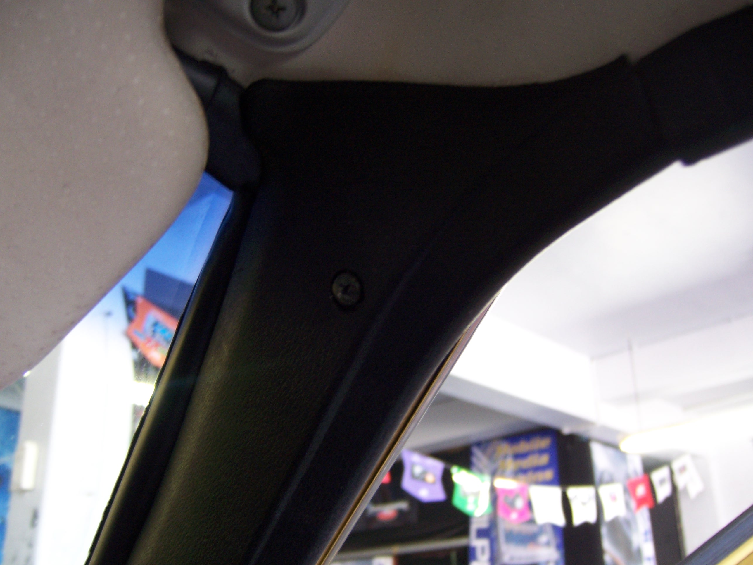

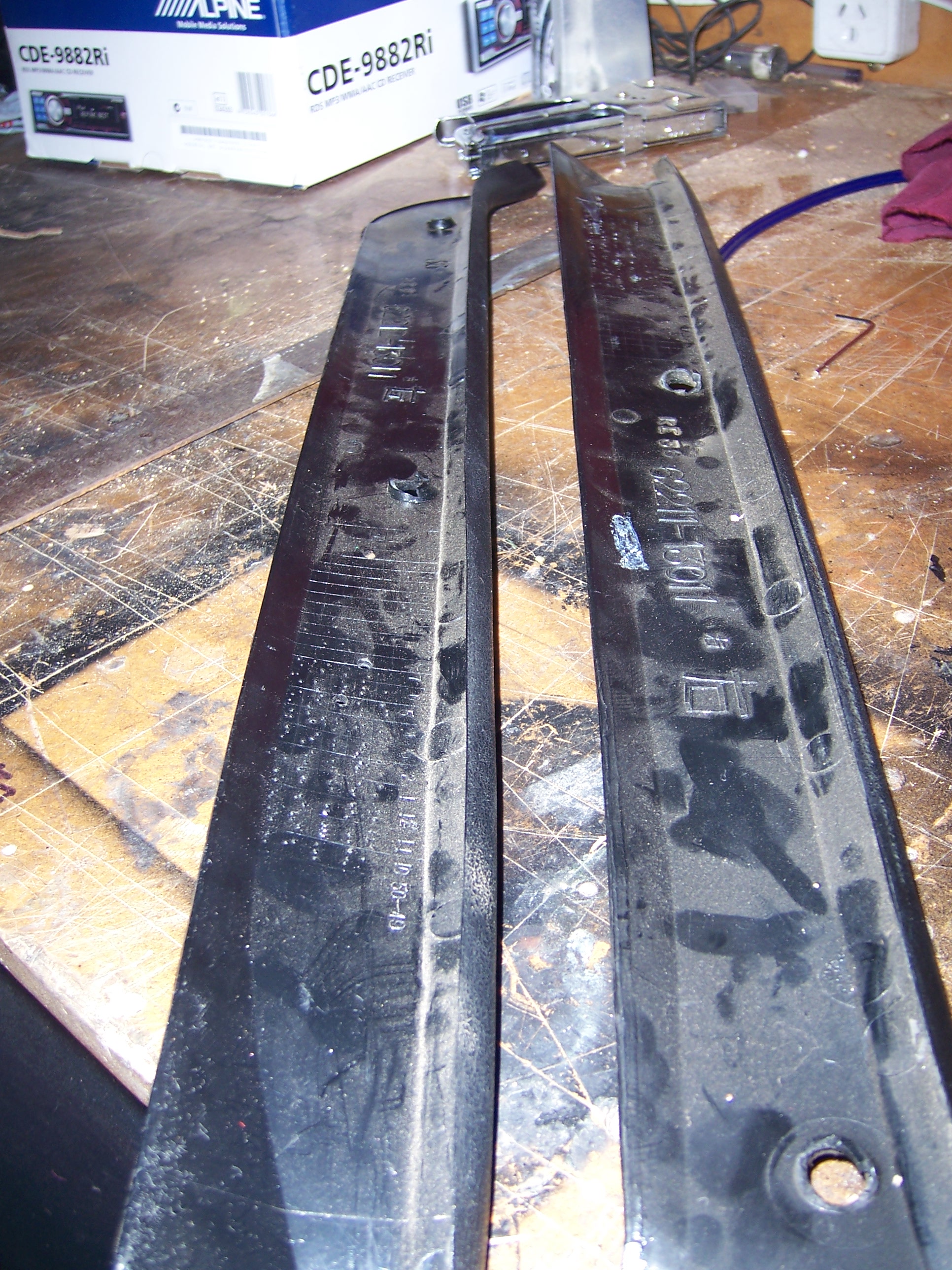

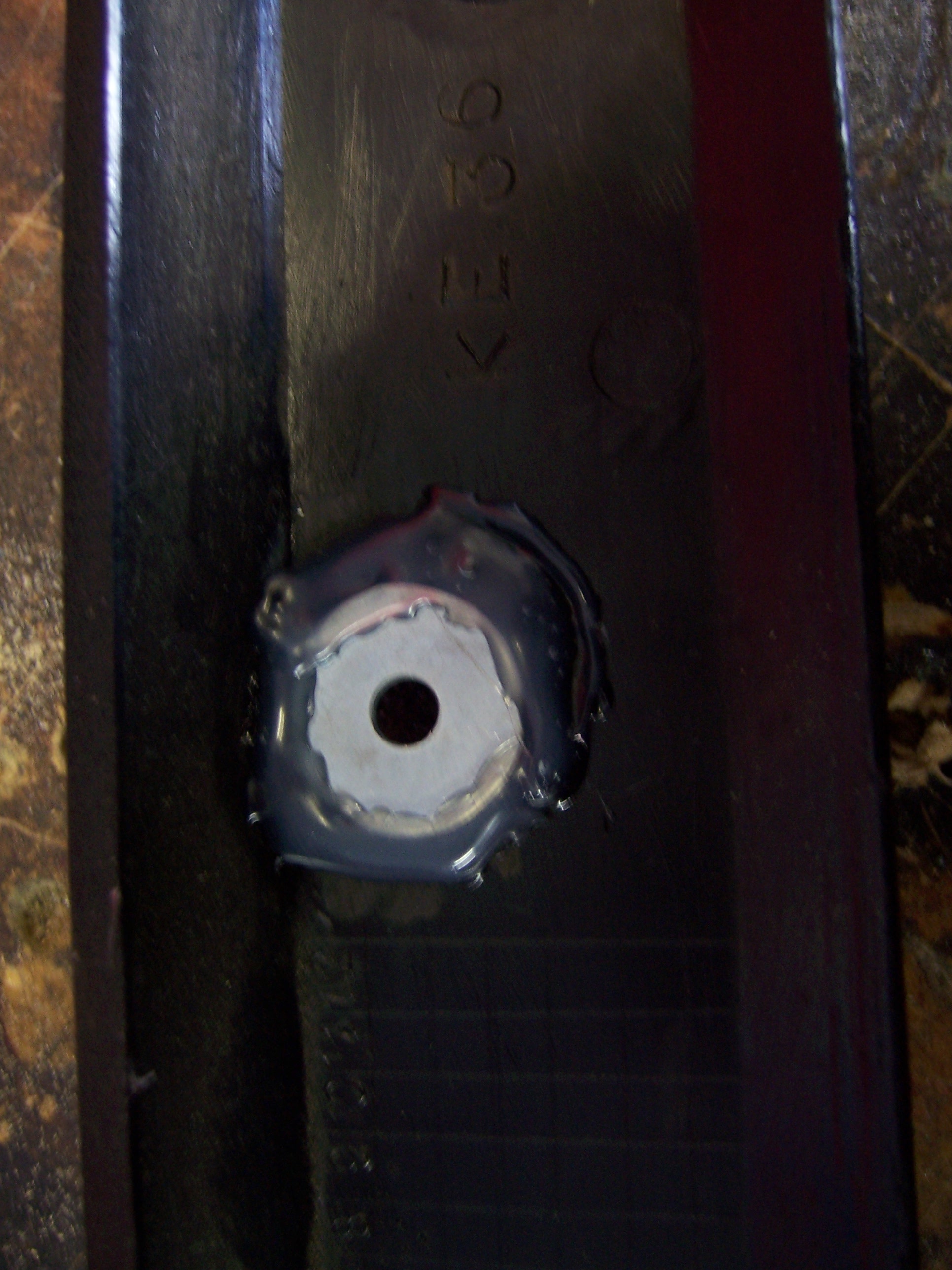

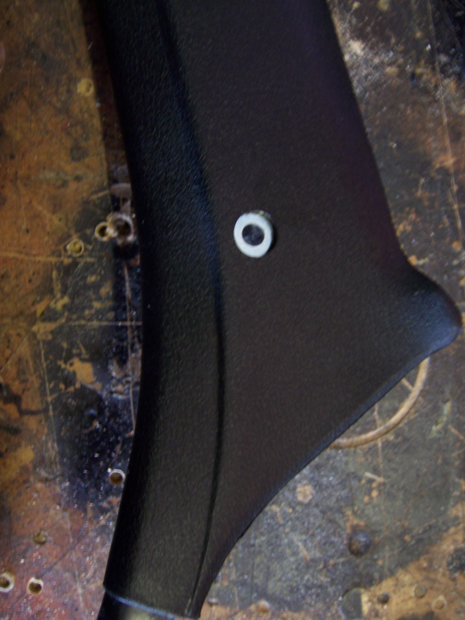

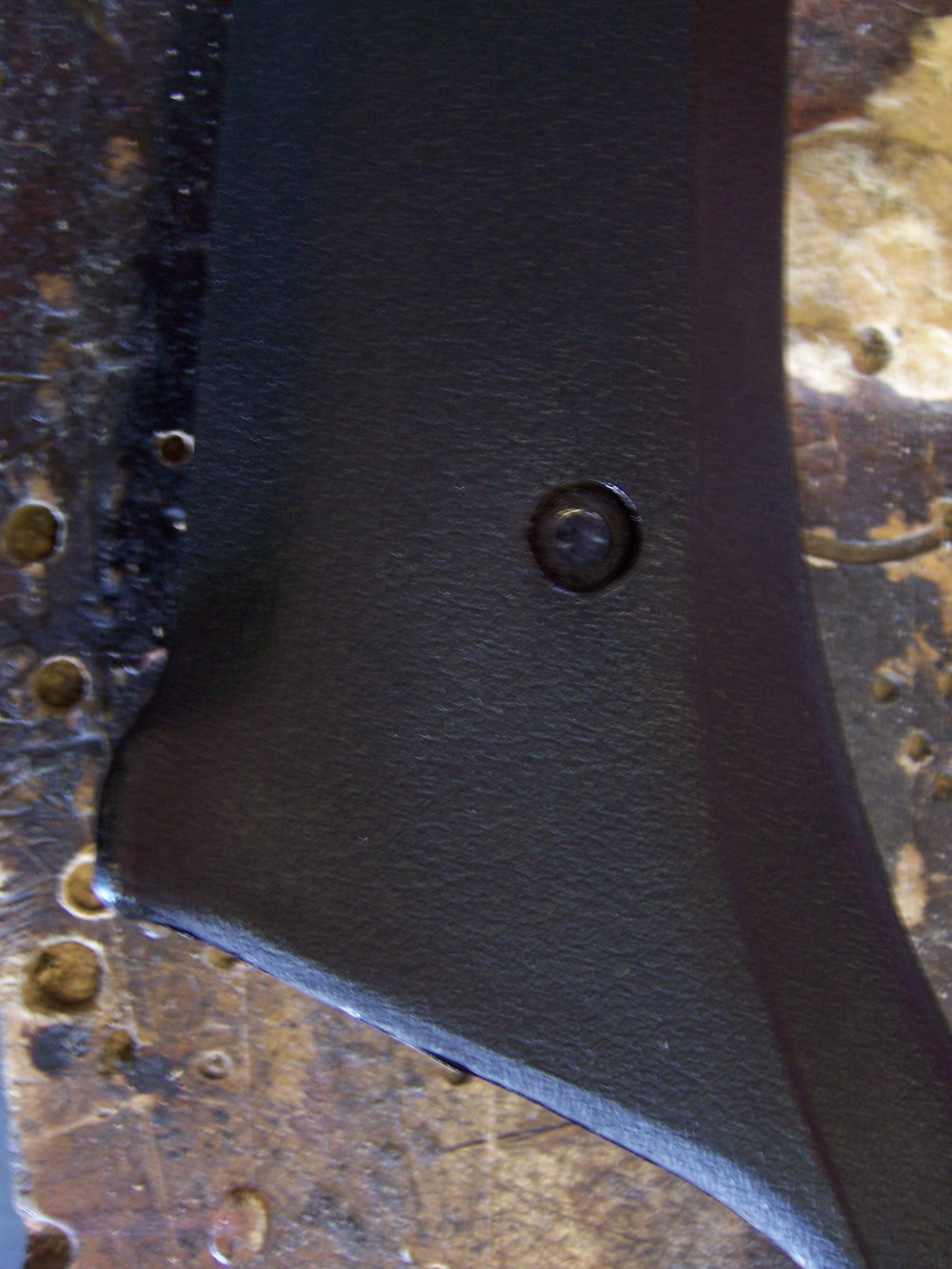

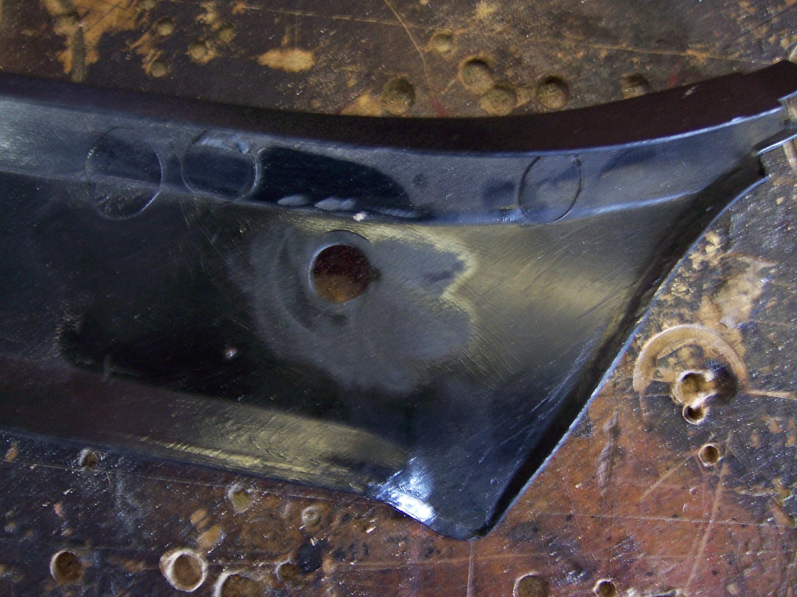

Taz_Rx Posted October 4, 2008 Report Posted October 4, 2008 This seems to be a common problem as its happened to a couple of my cars, so I thought I'd do a quick 'how to' while I fixed mine as both were broken... Step 1. Use a dremmel to grind back whats left of the broken platic seat. Step 2. Sit a suitably sized washer over the hole so that its centred and hold it there. Step 3. Glue the washer to the plastic from behind. I'm using hot glue, but sickaflex would probably be better. Step 4. Use a black permanent marker to hide the washer as some of it can still be seen with the screw in. Step 5. Re-fit to car! :hmm:

Taz_Rx Posted April 28, 2009 Author Report Posted April 28, 2009 Yeah mate, can pretty much just any clue that won't melt the plastic badly - like some superglue will. Would probably also recommend NOT using hot-glue as mine has already cracked off again. Just about to re-do them with sikaflex. :P

Twinky Posted November 22, 2010 Report Posted November 22, 2010 A good glue option could also be araldite, Use the 5 min araldite and it can have a bit of flex but plenty of grip.
Taz_Rx Posted November 22, 2010 Author Report Posted November 22, 2010 A good glue option could also be araldite, Use the 5 min araldite and it can have a bit of flex but plenty of grip. My original hot glue (pictured above) ended up cracking away, I ended up re-doing it with 24 hour areldite and never had a problem since. :wink:
