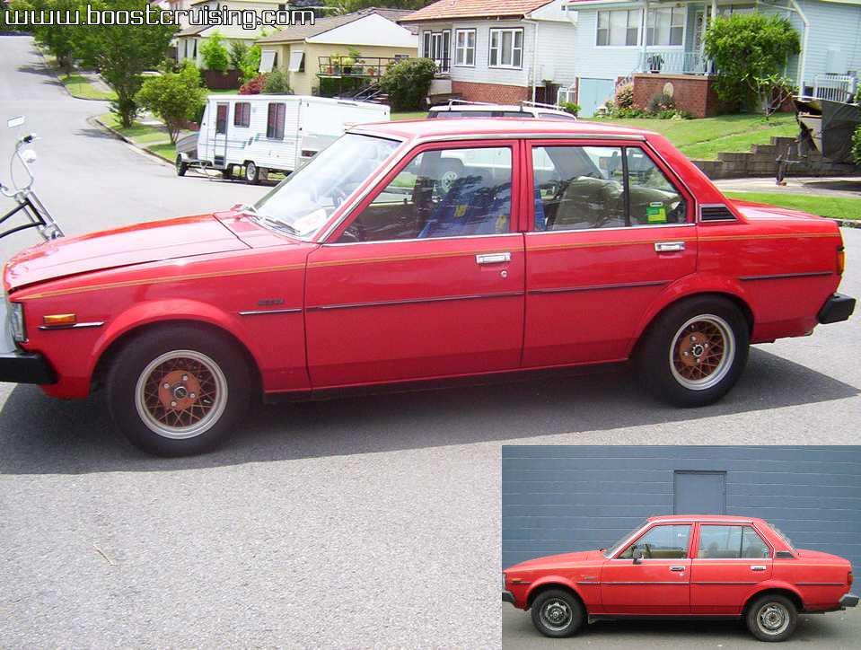

Teddy Posted December 20, 2005 Report Posted December 20, 2005 il try and do a chop for you... oh do you have MSN btw ? lol Here we go... small car - stock - big red car - looks to have king spring lows (or similar) - its about that height. Quote

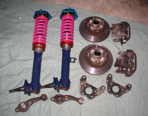

ae71neo Posted December 21, 2005 Report Posted December 21, 2005 (edited) oli said: Is there someone out there that have actually taken suspension/bits from an ae86 and bolted them on no fuss? that can help answer these q's please? If i had access to an ae86 i'd try it and report back so we know exactly what fits and what doesn't............ Ok i might be able to help you a bit. I have a AE71, the AE86 panhard rod bolted straight in, i've got AE86 coilovers for the front, for them to be installed you need 86/aftermarket strut tops, 86 steering arms and brake setup. But thats as much as i can tell you, because thats all the AE86 i have in my car at the moment. Oh and i have some AE86 superpro contolr arm bushes here, which i am pretty sure will fit the AE71, but i will find out for sure sooner or later! Edited December 21, 2005 by ae71neo Quote

oli Posted December 21, 2005 Author Report Posted December 21, 2005 Teddy said: il try and do a chop for you... oh do you have MSN btw ? lol Here we go... small car - stock - big red car - looks to have king spring lows (or similar) - its about that height. That drop is decent enough for me... so that's a legal drop? I don't think there are any legalities here abuot how low you want to be. The Monroe sport shocks enough to cope with this I take it.... If as david says the ke70 bushes are identical I can get these here in the uk so might pass on those... I will have to digest the rest of the ino sometime as you all have some decent info and comments that I need to respond to Cheers dudes :) Quote
