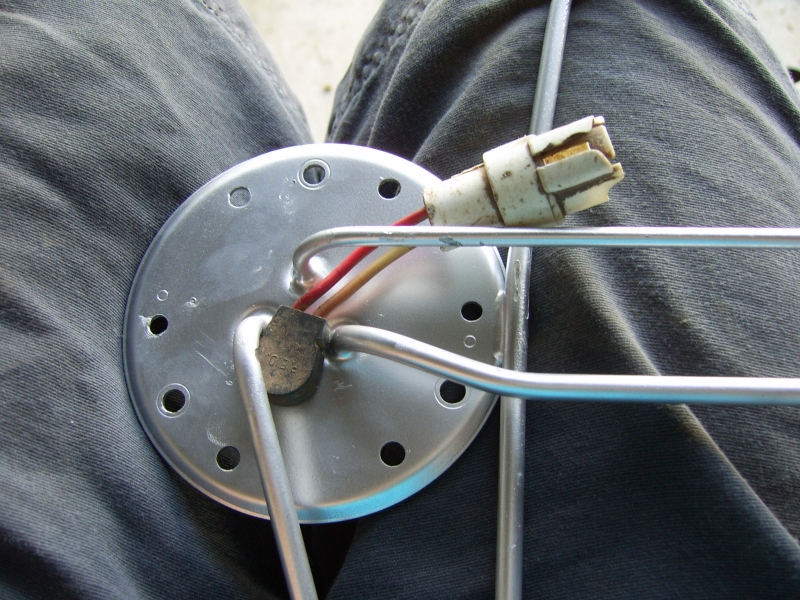

Here is a photo of where I drilled a hole in the AE86 fuel line setup for the VL wiring connector to go.
Underside shot of where I drilled the hole in the AE86 fuel line setup for the VL wiring connector to go.
The VL In-Tank wiring connector removed from previous setup.
The VL In-Tank wiring connector installed / wired into the AE86 fuel line setup. (bottom view).
The VL In-Tank wiring connector installed to the ae86 fuel line setup (Top view)

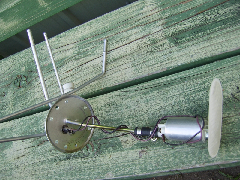

The complete converted setup ready to install into AE86 fuel tank.
