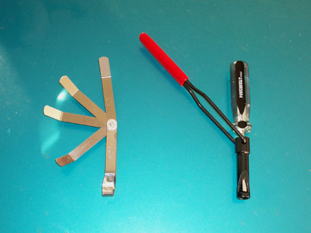

The only tools required are:
14mm socket or spanner (to remove tappet cover nuts)
Feeler guages
12mm ring spanner
Medium sized flat head screw driver
You can also get proper valve adjustment tools which are basically the ring spanner and screw driver combined in one unit. They are no way manditory, but do make the job a lot easier. Here is one pictured below.
